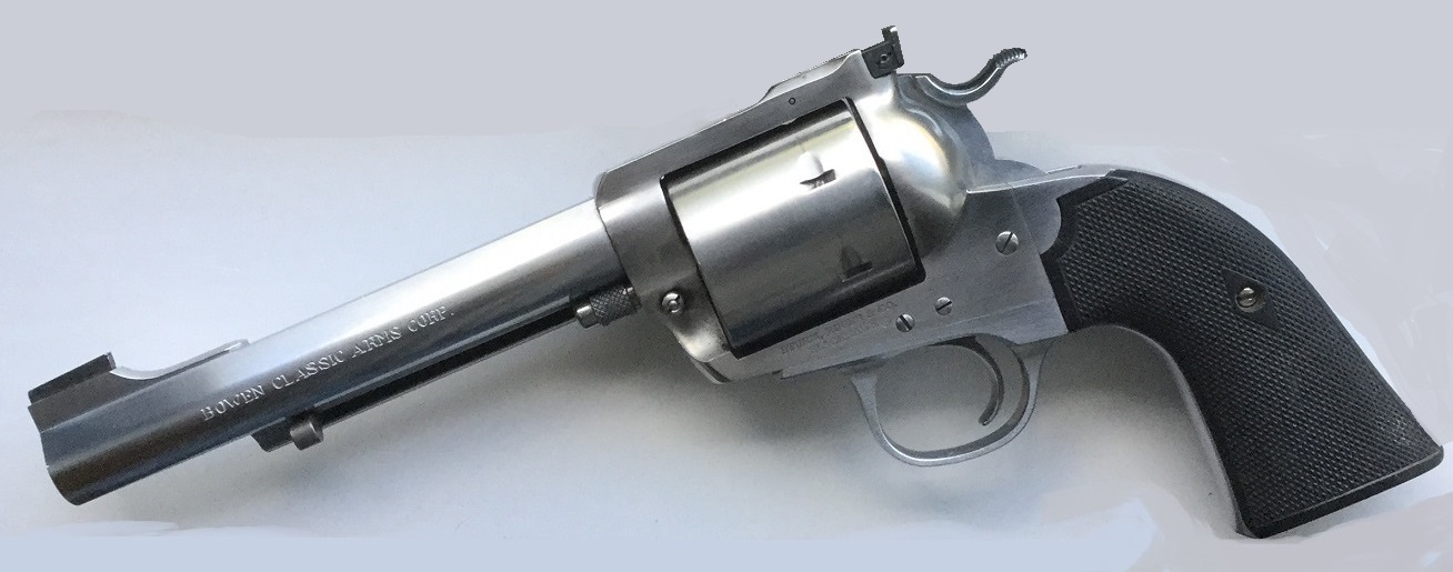

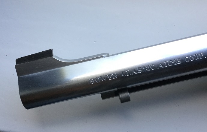

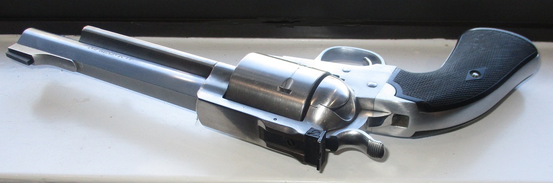

The gun was a Ruger Super Blackhawk .44 Magnum. It was worn and tired and Jack sent to Hamilton Bowen. He wanted a custom gun and Hamilton built it for him. He even Taylor-throated the barrel.

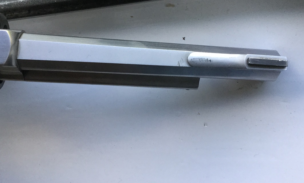

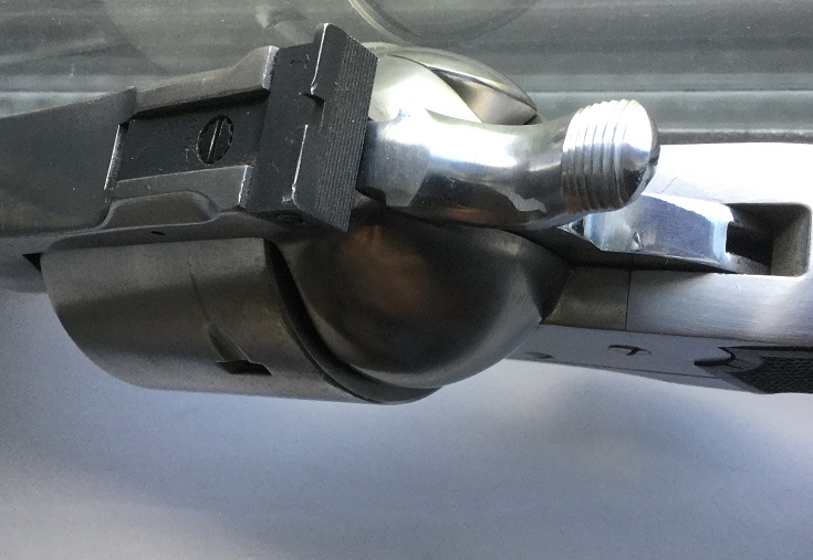

The sixgun carries Bowen's sights front and rear.

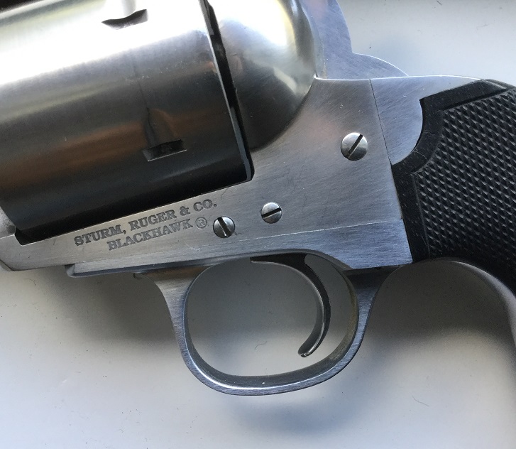

The barrel is an "ovate rib" and tapers 3 directions. Bowen made the .41 Magnum cylinder also. It also has a "3rd screw" added. It is actually a cylinder bolt stop that keeps the cylinder bolt from battering when the gun is cocked rapidly.

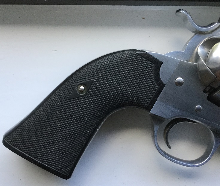

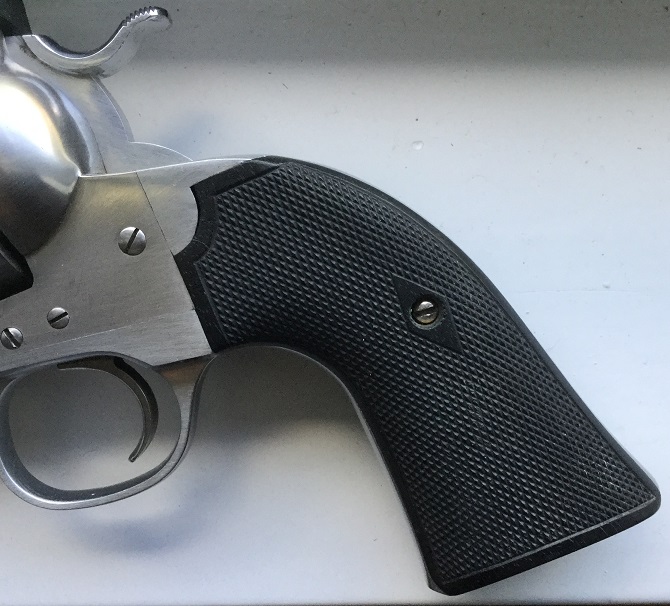

When I got the gun it had the Super Blackhawk grip and hammer with a set of Charles Able grips on it. I have never cared for the SBH grip shape or hammer and I had Milt Morrison of Qualite' Pistol and Revolver install the Bisley gripframe and hammer. Paul Persinger made the Ebony grips and hand checkered them.
I had Gary Reeder make a new cylinder. I had been testing some factory ammo sent to me and one round bulged the bolt stop slot in the cylinder. I sent the ammo back with a note but never heard anything from them. I fired some in my Marlin Model 94 .41 Magnum and it blew the hammer back to half cock and went through the chronograph at close to 2000 fps.
While Gary had the gun I had him install his "Set back" trigger. The trigger stays at the rear of the trigger guard like God intended and the action does not sound like a cap pistol when you dry-fire it.

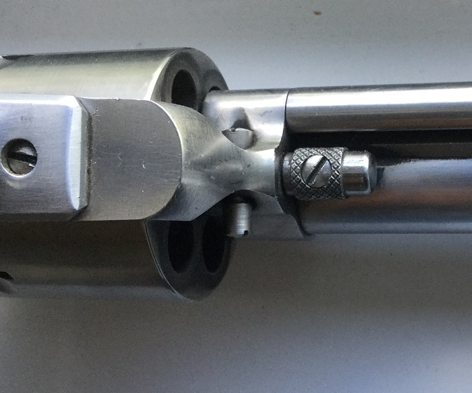

The cylinder pin has a nice locking feature and has never worked loose, even with the heaviest loads.

I remember firing this gun a couple of years back in Arkansas. I think I like that front sight better than any other I have ever seen.
