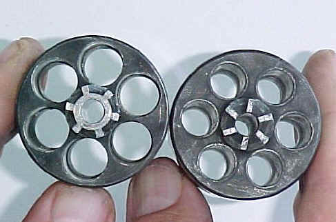

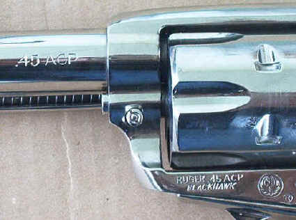

The gun and parts were shipped off to Jim Stroh of Alpha Precision in Georgia. Jim had done other work for me in the past with which I was pleased ... and I had made a deal with him where I did some website work for him in trade for him doing some gunsmithing for me. I told him I wanted the cylinder rechambered to .45 ACP, the .45 Colt barrel installed and shortened to 3 1/2" to 4"...however short he could get it and still have an ejector that worked. I needed the new parts installed and the gun timed and the trigger pull worked on. I did not want any finish put on the gun as I have other plans that I still have not finalized in my mind. Jim was agreeable to the deal and the gun was shipped to him.

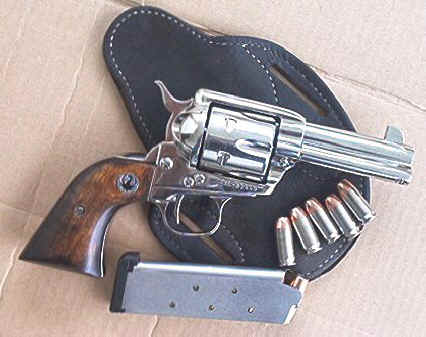

(5) You can use 1911 magazines as speedloaders for an ACP sixgun ... nice, flat, easy to carry.

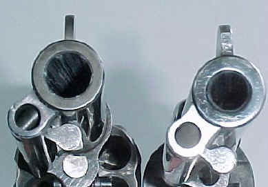

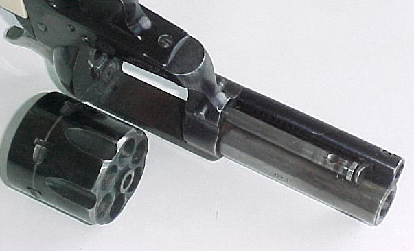

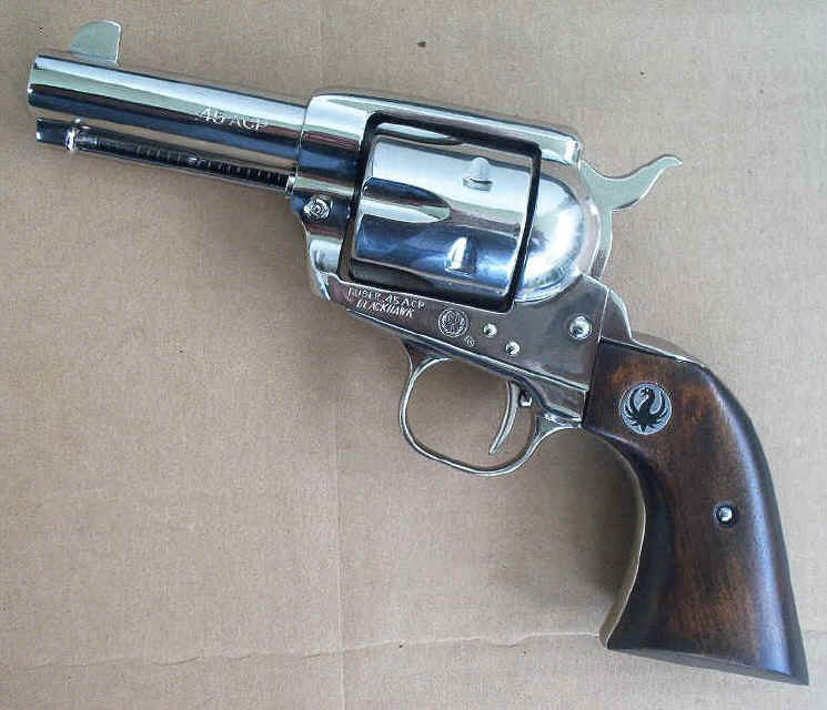

When I got the gun back from Alpha Precision I was extremely pleased. Mr. Stroh had done everything I asked. The barrel was cut to 3 5/8" .. as short as you can get it and still have the cylinder pin work. On this frame size, with a shorter barrel that has an ejector rod, the cylinder pin will not slide far enough forward to allow you to get the cylinder out. Mr. Stroh had shortened the head of the cylinder pin and flattened it to get it as short as possible. There is a "fingernail notch" on the underside of the pin to allow you someplace to get ahold of it and slide it forward when you want to remove the cylinder.
The barrel had been turned so there was no writing on it. This also brought the O.D. down to about the diameter of the original .357 barrel. He had left the front sight purposely high so I would have plenty of material to work with when I sighted it in. I had asked him not to make the gun too tight. This is to be a "using" gun and I want it to function if it is dirty from lots of shooting, or if it gets dropped in mud or whatever. I also asked him to not turn the back off the cylinder. I do not plan on using Auto Rim cases (or moon clips) in this particular firearm.

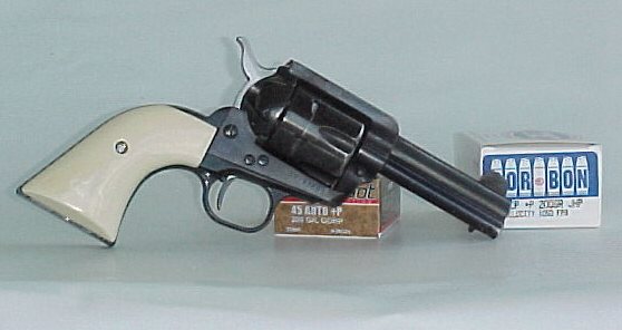

I began shooting it using Cor-Bon's +P ammo as well as Speer's Gold Dot ammo. Bullet weights of 185 gr., 200 gr., and 230 gr. were used. It soon became apparent that the Cor-Bon ammo worked the best in this gun as far as accuracy was concerned. After shooting quite a bit I decided to cut the front sight for the Cor-Bon ammo. These will be my "social loads". Accordingly I filed the front sight so the gun hits near POA with 185 gr. JHP and the 200 gr. JHP +P loads at 25 yards.

I fired a number of targets with different kinds of ammo at 15 yards. These were fired with a 2-hand hold, bringing the gun up quickly, catching the front sight and firing fairly rapidly. It was pretty easy to put 5 shots into 2" or less. As the intended purpose for this gun is social, not hunting, it fills the requirements pretty well.

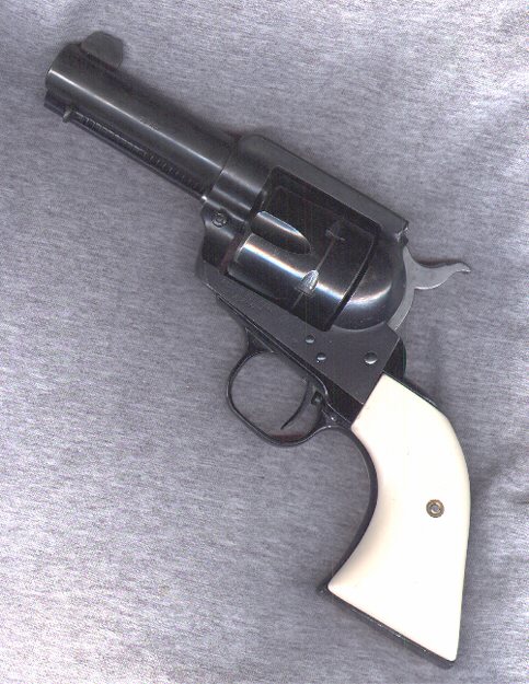

The gripframe on the gun is an XR3 grip I got in trade. I installed a set of Grip Maker's stocks on it and put the factory ones away.
I rounded the front edges of the cylinder to make it easier to slip into the waistband, and because I like the looks. And I straightened the trigger a bit. Just a personal thing I like on my sixguns.

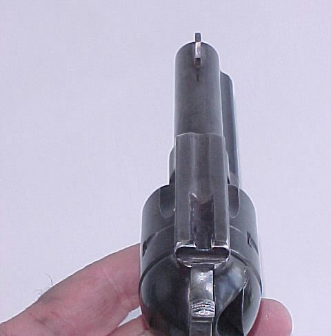

Next I removed the rear sight and took it apart. Using a fine-bladed hacksaw I cut down through the sight body in the sight blade slot. Then using a Dremel Tool (and sandpaper and elbow grease) I reshaped the sight and the top strap into a fixed sight. (this was done before final sighting in).

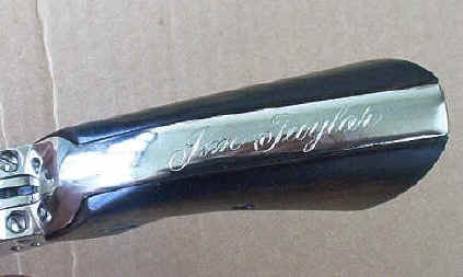

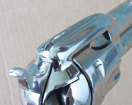

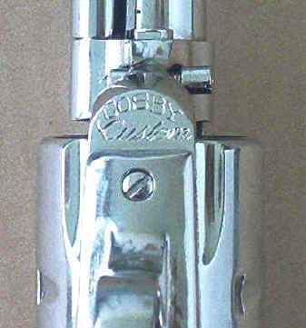

After I used the gun awhile I sent it to Brian Cosby of Cosby Custom Guns. He cut and reshaped the top strap to resemble the Colt SAA, polished the gun and then nickle plated it. It sure did turn our nice!
