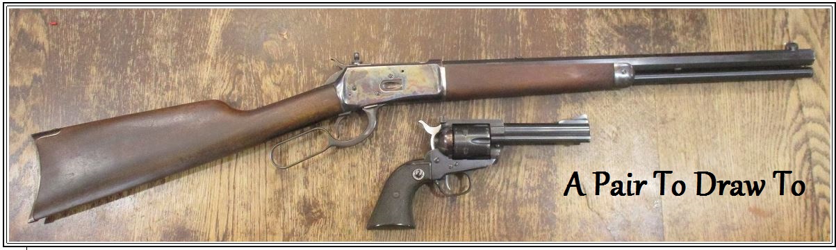

by JimT, Texas, Saturday, April 02, 2022, 07:32 (1647 days ago) @ Frank S
All Leverguns are fun! These days I am partial to the .357 ... fits my needs and the time of life I am in.
